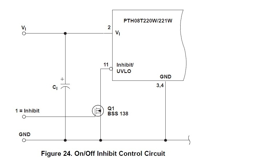

I don't understand the Inhibt/ULVO pin in  low state . floating , the power moudle will in which function?
In Figure 24, Inhibit = H condition ,Q1 will turn on, and  power moudle will turn on ,
but when Inhibit =L condition , Q1 will turn off , the power moudle  will be  ?
  • Yang:
    1.PTH08T220WAx when operated at Vo=1.1V with Vi= 12V and I used PTH08T220WAZ. (Vo*11 > Vi), the output  ripple may increase up to 16mV.
    However, by adding 100µF( X5R) ceramic capacitors can reduce output ripple by 20%-40% or more. The total ripple at 1.1V will likely be about 10-12mV over the entire output current range with 12 Vin.
    2.PTH08T220W , when Inhibit pin is open or high ,  it will function normally . There will be a normal  output voltage , when autotrack pin,pin 10,  is also high or open.
    a. When the inhibit pin is pulled to ground (low) with (FET) Q1 drain  , High gate voltage on Q1 , the module is disabled.

    Note:
    A 2 FET control method for enabling power modulewhen power is applied and the  inhibit is low from Q2.
