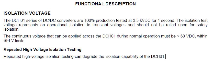

Is it possible to use DCH010515S  as power supply for gate driver circuit for IGBT like NGTB15N60S1EG?
I am trying to built a prototype of multilevel converter, which requires very large number of switches.  Just to prove the concept of control strategy, the implementation of the converter would be simple and cost effective way. The maximum current could be around 6-7 A and the voltage across each switch is 130V. I am thinking to make the gate driver circuit as simple as possible. The power supply of DCH010515S  would be connected to any optocoupler (let's say FOD3180) and the output of FOD3180 would be connected to the IGBT through gate register.
I am implementing the hardware first time. Please suggest.
