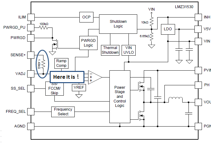

Since the FB pin is not set in the LMZ 31530, it is not known whether the following circuit can be constructed.
However, looking at the internal circuit, it seems that it can be realized because only the high side of the FB divider resistance is built in.

  • It is not recommended to add the external feedback and compensation components to the VADJ pin of the LMZ31530.
    If output voltage adjustment is required, reference the app-note below (SNVA709).

    I compared the SNVA709 with PMP7256.
    Is this thing correct with the following idea?
    ・The principle that the output voltage is changed by the current injected to the FB pin using the D-A Converter is the same.
    ・Since LMZ315x0 is a product that does not require loop compensation, compensation circuits mustn't connect.

  • Yes, injecting current into the FB pin will change the output voltage. It is not recommended to apply external compensation components to this device.
