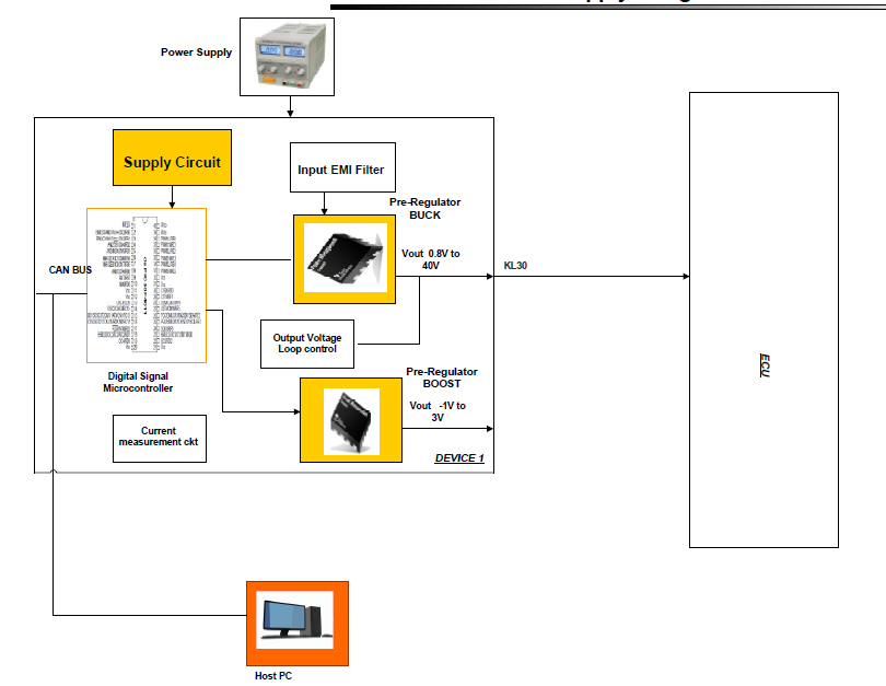

Hello All ,
My question is regarding use of TPS84259 , using negative output integrated solution along with LM25117-Q1 as first smps IC.
Power supply input from the main power supply will be from 12V to 48V Vbatt.for both IC's  adjusable.
Can TPS84259 ouput voltage be adjusted by a MC, as TPS84259  does not have  FB pin. I wish to adjust the voltage from the range from -1V to pos (0.8V - 5V )......Is it possible to come from -1V to positive or 0V in this IC . ??
My first IC provides Vout from 0.8V to 40V , with Iout upto 20A,
