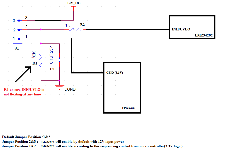

       Please find the attached image for sequencing control of LMZ34202.Do the setting shown in image enough to perfom the ON-sequencing and OFF-sequencing of LMZ34202?

    Solution to avoid the above problems
    So for avoiding the floating of INH/UVLO pin and to make sure LMZ34202 will be turned ON only when GPIO of uC/FPGA is at high the circuit arrangement shown in the attached image is performed.
    Please find the attached image.
    When the jumper is at position 1&2, the resistor R1 ensures that INH/UVLO pin is not floating even if the GPIO of uC/FPFA at high-impedance during power-ON.
    LMZ34202 will start switching only when GPIO is made at logic high(3.3V).
    But here the GPIO is not an open-drain pin, it is a normal logic pin.
    Question1: Do the circuit attached to the image is sufficient to perform the sequencing ON and OFF for LMZ34202?
    Question2: I think it is acceptable to drive INH/UVLO with normal GPIO. Not mandatory to have an open-drain pin.
                         Page-17, paragraph-2 of the datasheet says INH/UVLO pin can be driven by a logic pin not necessarily open-drain. Please find the attached image.
                         So is it okay to drive INH/UVLO with a normal GPIO pin?

  • HI Deepak,
    Sorry that I missed this reply. This must have slipped through my email filter.
    To answer your two concerns:
    1. Yes the R1(82k) resistor will ensure that the LMZ34202 will not be floating if the GPIO doesn't send a logic input.
    2. Yes the INH/UVLO pin can take logic input directly. In your case it will be the logic input from the uC GPIO.
