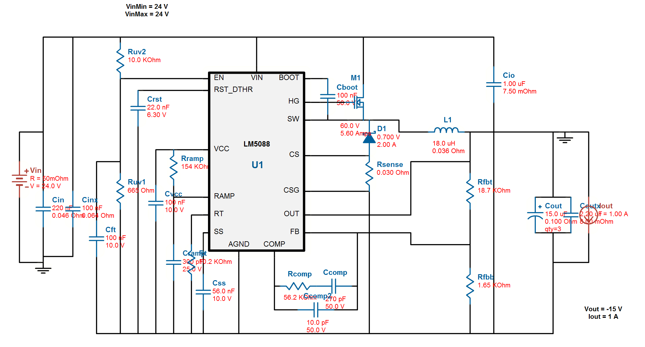

  • I have a similar situation, but using a -15V supply.  I've attached the webbench schematic similar to what I have on my board.  Problem is, I'm getting LOTS of noise (3-4V) at 300KHz.  It seems that there is an issue with the ground (Vout) of my -15V coupling noise onto the shared ground of my positive supplies.  Is there a special way to connect the LM5088 in inverted mode with positive supplies that share the same input source?
