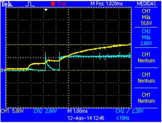

  • Hello Arief
    I have done some tests and I believe the problem is the EN threshold.
    My EN is tied to the ucontroller pin and the output of the pin is 3V.
    IMAGE1:
    CH1 - Vin (2.9V)
    CH2 - PIN8
    (current  = 240mA)

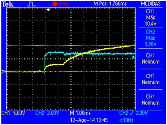

    IMAGE2:
    CH1 - Vin (4.2V)
    CH2 - PIN8
    (current = 30mA)

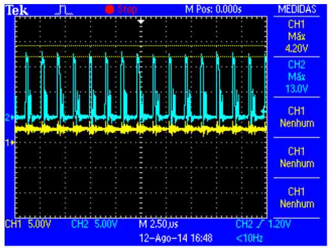

    IMAGE3:
    CH1 - Vout
    CH2 - PIN2 (EN)
    (Vin = 2.9V - current = 240mA)

  • It looks like when you are at lower VIN, you switched more, hence the higher current that you see on the input whereas when you at 4.2V, you can see that the switching is happening less so you'll see the low value of input current.

    This user's circuit has a number of errors, but the waveforms help zero in on the cause of the startup issue
    The enable pin glitch is a false lead; only its magnitude is significant. Vout doesn't begin to rise above Vin
    until En is stable. The reason for the poor behavior is that the bangap reference isn't sending the signal to the
    comparator needed to enable the voltage loop; the reference sends this signal only when it has enough head
    room to be operational.
    Whatever is happening with the switch pin low (nfet on), whether the current is still ratcheting up or it's
    in current limit, it's seen that, when the switch turns off, the drain voltage is clamped only by the nfet's
    esd zener. That's where all the power is going. Vout rises, in fact, over ten volts; clearly the comparator
    is not involved in the process.  Until the comparator is enabled, the driver will simply run at ~70% duty
    cycle as long as there is > 1.1V (hvpmos vt) on Vdd and en. This architecture allows the part to bootstrap
    from Vdd < 2.5V, the headroom required by the reference over temp. Image 3 shows en (and thus Vdd)
    settling to ~ 2.0V, +/- a fair amount of noise. This might be sufficient headroom at 125C, but is definitely
    not enough at room temp, especially with a power device driver hanging off the same linear supply.
    Additionally, the power nfet's gate drive is not well served by connecting it to a 3V rail; this will kill the
    efficiency. Boot, Vdd, and En should all be connected to Vout for this application. They are all, in fact,
