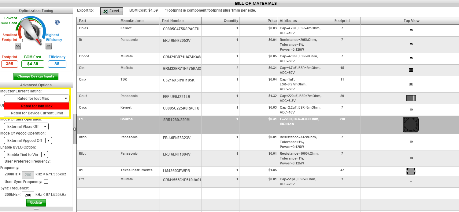

  • Additionally, WEBENCH gives you the option to size the inductor current rating based on the max Iout (of this application, 3A) or the device current limit (5.5A).  It is located on the left panel under Advanced Options:
