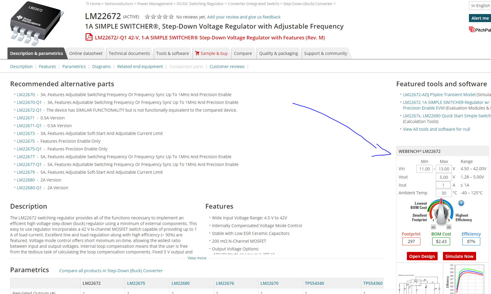

  • Hi Mervyn,
    Please go the LM22672 webpage and use WEBENCH to calculate your circuit requirements. It will simulate it for you and provide layouts and schematics.
    It will look something like this:
    Anston
  • Hi Anson:
    At first, thanks for your replay, I can get circuit from input parameters to WEBENCH. But I still have a question, how WEBENCH caculate parameters. Can you supply some details, thank you.
    Mervyn
  • Mervyn,
    We put the Pspice model in this tool. It also has a huge passives library that allows us to select the best component available.
    If something is unclear, please specify exactly what you need.
    Anston
