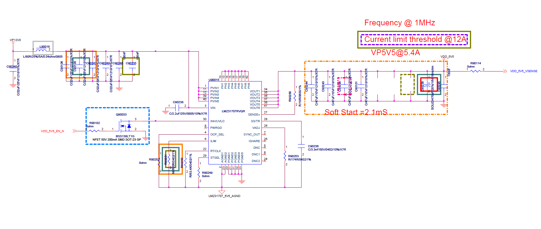

  We are trying to measure bode plot on LMZ31707 but the test result is fail.
We put 20 ohm between sense+ pin to Vout pin & inject noise to measure it.
Out test equipment is Venable 3120.
Would you have any suggestion about the test method? Or do you suggest to measure bode plot for LMZ31707?
Attached schematic & test result, FYR.
Thanks.

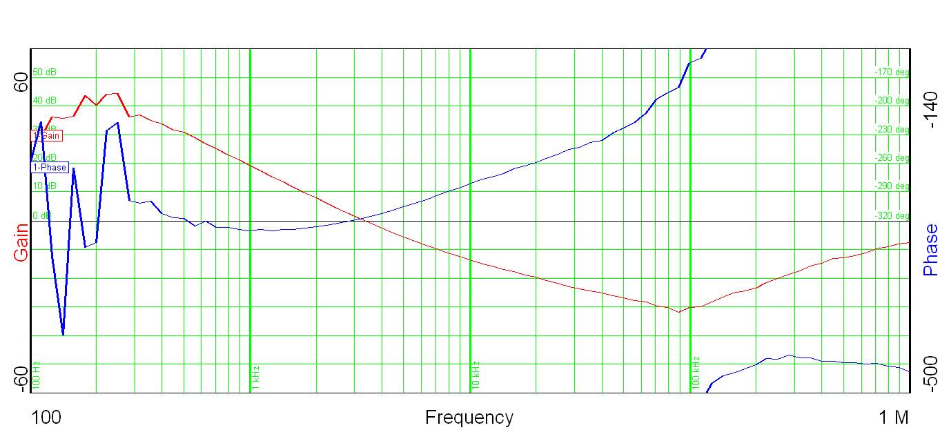

  • Hi Hung,
      We already use your method to measure it but result was attached on last mail.
    Do you have any suggestion for the test result?
    You can see the phase line is going to up but not going down.
    Thanks.
  • Hi ShihChin,
    Can you please show me how you connected the measurements in details?  Meanwhile, please let me know the operating conditions, including Vin, Vout, and Iout.  Furthermore, what the board under tests used exactly same component values you had shown in the schematics?
