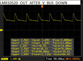

We switch the input to the LMR10520 using a TPS2115 from V_BUS to 5V_FROM_12V as seen in the schematic bellow.
Everything works fine as long as we have V_BUS connected and at 5V but the issue is when we disconnect V_BUS.
The 5V_OUT after V_BUS is down is shown in first picture and the LMR10520 output is presented in second picture.
Why this behavior?
