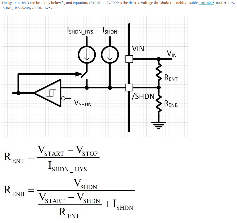

in my design I'm using the LMR16006 simple switcher. I want to add a voltage divider to the SHDN pin to set the UVLO to about 20V.
The datasheets states that the rising !SHDN threshold is 1.05V to 1.38V but there is no information about the falling !SHDN threshold or the hysteresis voltage.
There is a hysteresis current though. But i don't know what that means.
Is there a way to calculate the hysteresis voltage from the hysteresis current using the impedance of my resistive divider?
