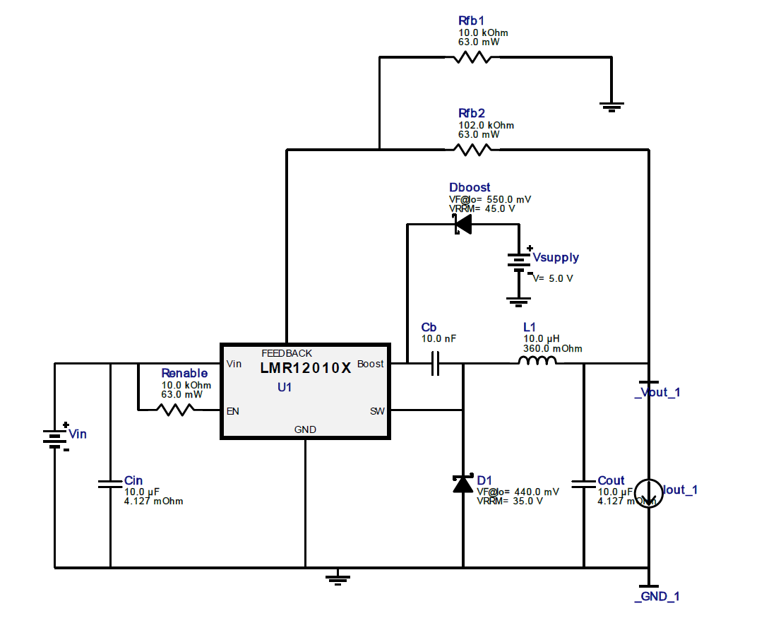

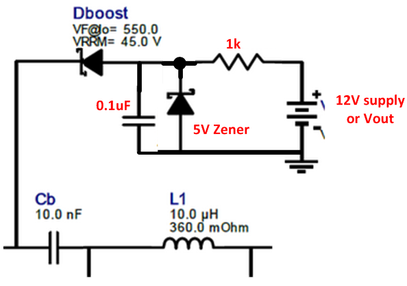

I use TI webench to design power supply.
The circuit is below.
I want to replace the Vsupply(5v) to Vin(12V)
