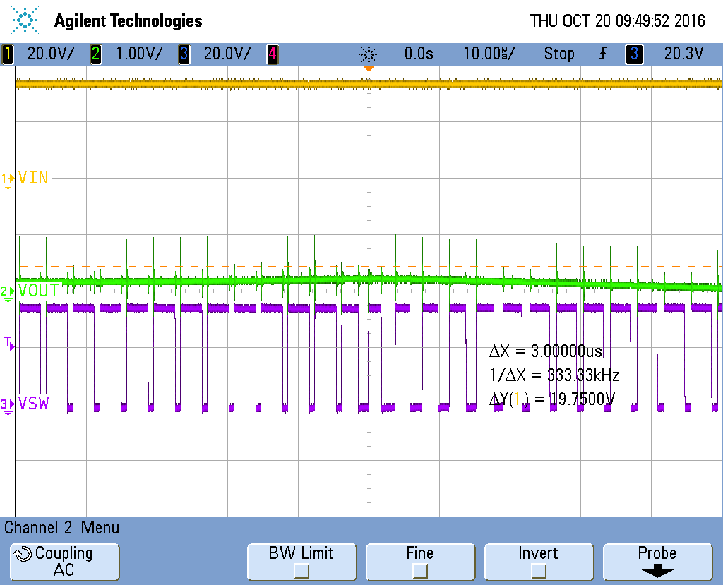

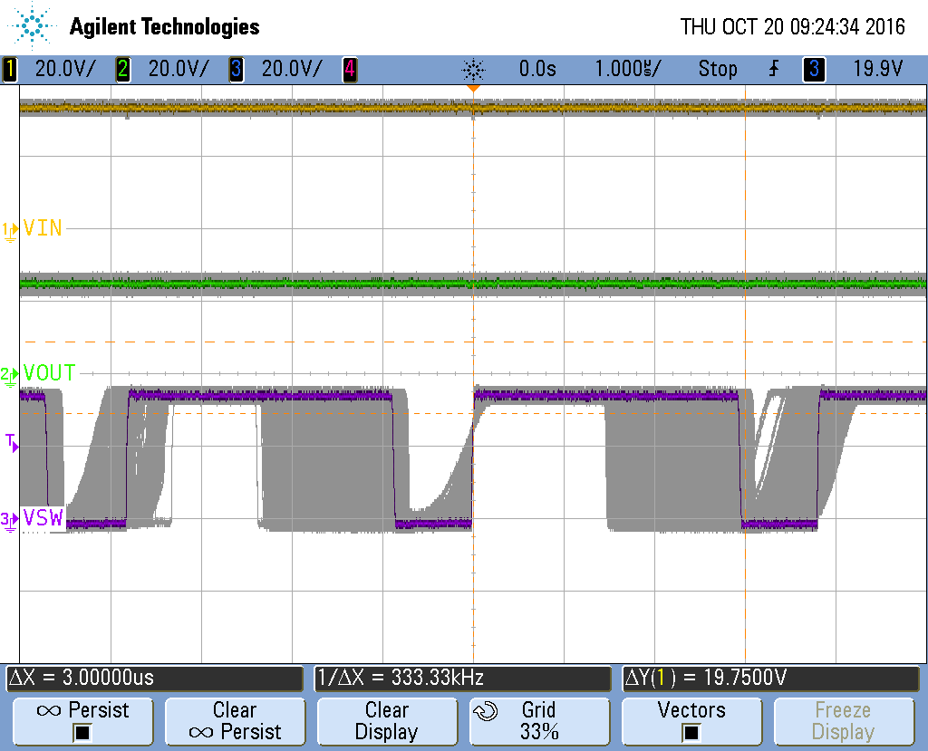

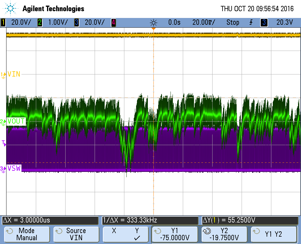

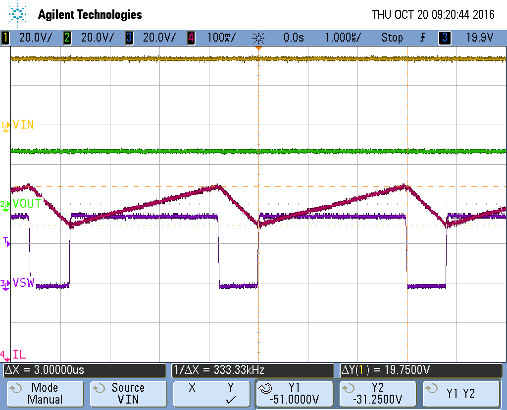

  • First  picture shows stable situation (450mA load, ripple ~ 100mA), the other pictures the instable situation (0->450mA loaded).
  • Thanks for sharing these. It does look as if the device is not being compensated properly. Use of LMR16010 or LM46001 should make it easy to stabilize. The layout is going to be important. Therefore I suggest following the layout guidelines closely.
