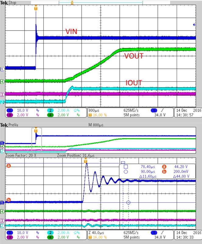

  • Yoshitaka san,
    I checked on bench, and see a large ringing on VIN , as high as 44V. This voltage may destory the device potentionally. The ringing amplitude depends on the speed the hot line is pluged, the faser, the larger ringing.

  • Yoshitaka san,
    Did ctm use FPWM version or PFM version devices? For FPWM version, we used to see the VIN is boosted to super high voltage as output is connected to 5V and input is floating.

  • Yoshitaka san,
    When the Vout is weakly pulled to 5V, the input voltage will be charged to 5V through the body diode of the HS FET. Then the device is active as the VIN is over its UVLO threshold. You will see the FEN turn on/off actions at such condition. Then hot plug the device to DC supply, the large ringing voltage (as high as 44V) may forced on either HS or LS FET, which may burn out the device.
    If Vout is is not pulled high to 5V, then the device won't be active. There is a delay time taht Vout start to ramp up after VIN is ready (refer to the waveform I attached above at earlier time). So even it's hot plugged to the DC supply with large VIN ring voltage, the HS/LS won't swich during this delay time. So the ringing voltage is forced on HS and LS FET in series, so every single FET only suffer half the ringing voltage, so it won't burn out the device.
    I think that's why different power on sequence will result in different results.
  • The soultion is to set the system UVLO is a bit higher than 5V throgh the EN Pin with EN divider resistors.
