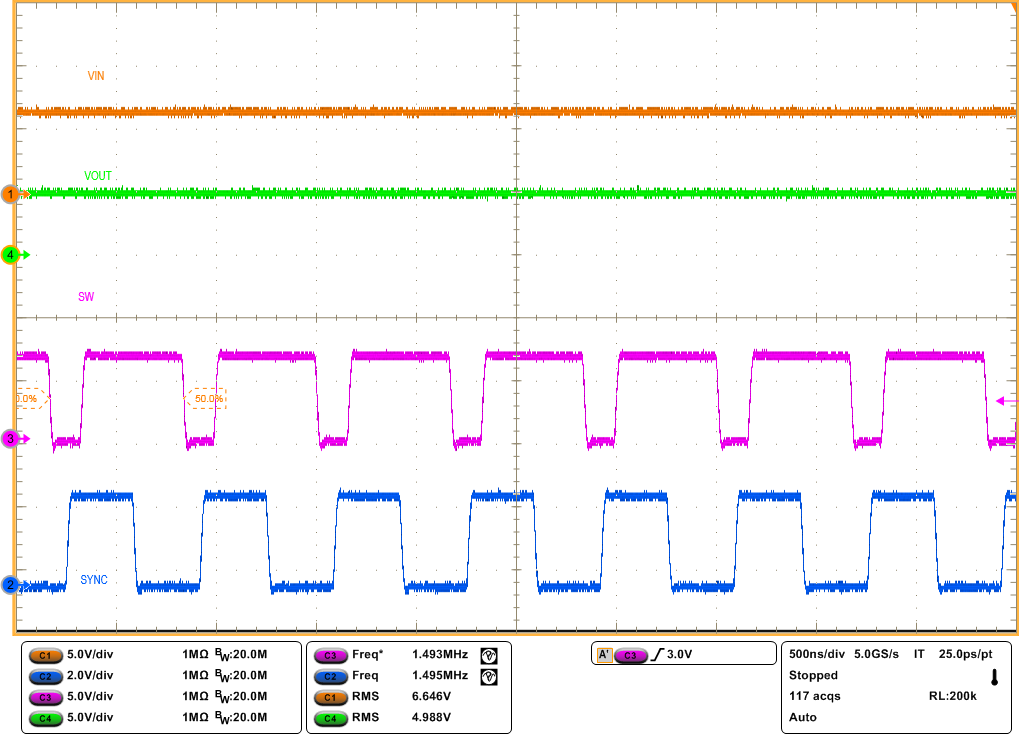

    Here are a couple of snapshots:
    Not in dropout yet: SW follows the SYNC signal:

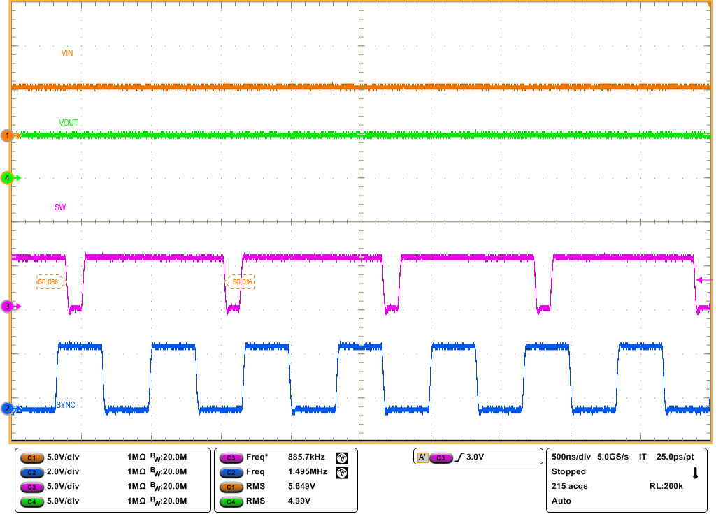

    Here is the regulator in dropout (notice the lower input voltage). The SW frequency is not locked to the external sync anymore and operates at lower frequency:

  • Hello Yamashiro-san,
    I confirmed with the applications engineer on that part that the FPWM version of the device has the same behavior.
    Cheers,
    Denislav
  • Hi Tateo,
    The cold crank is an abornarm condition and will not last for a long time. So pls check with ctm if the frequency foldback is acceptable in dropout. also the frequency foldback is designed to achieve low dropout at low VIN. without this function, the dropout voltage will be larger.
