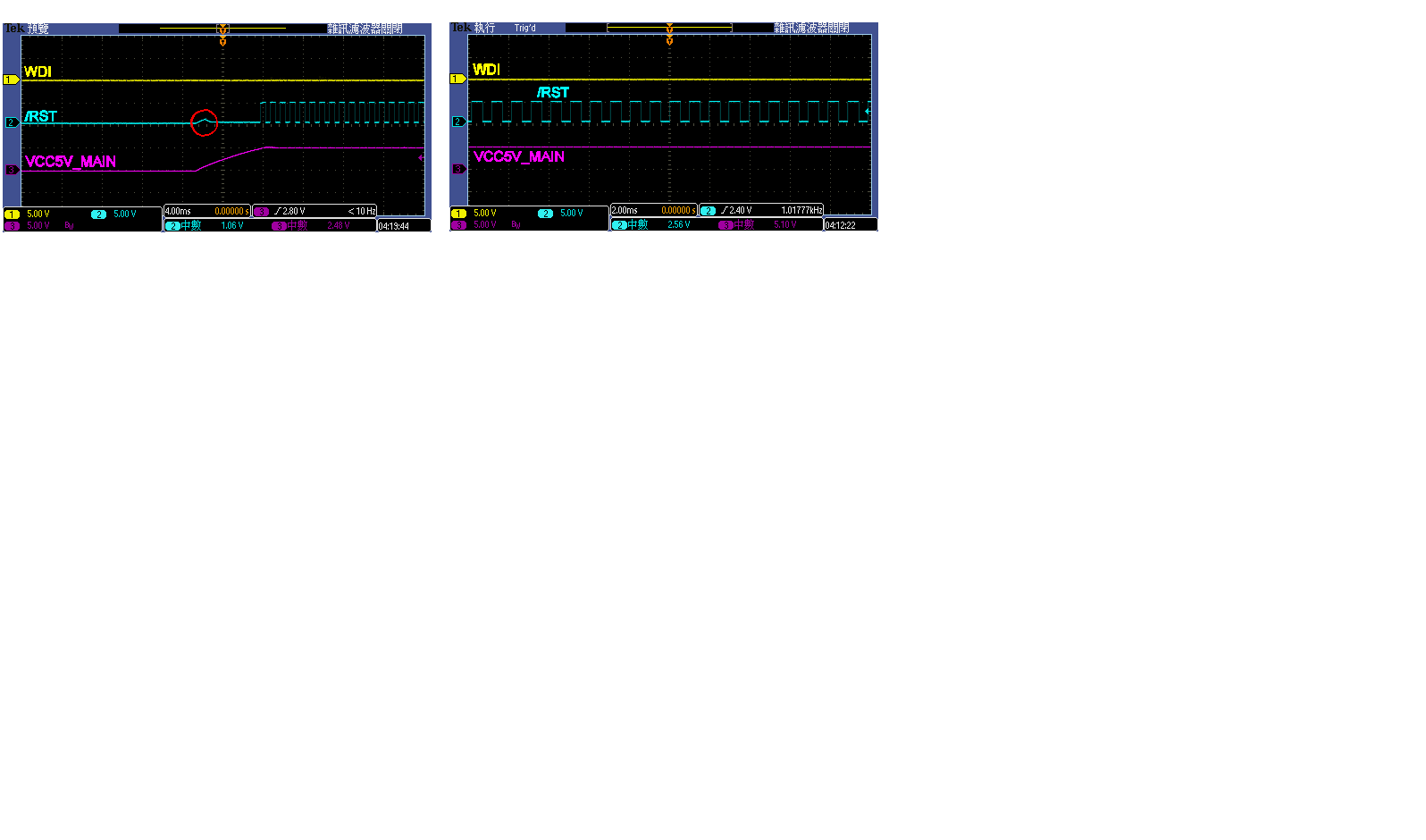

  • Dear David
    Pls refer as  below normal waveform.
    After VCC5V_MAIN + 470uF capacitor. thr Reset will keep having plus wavefor,.
    And another question is, when Vcc rising, RST have small spike(use red mark). is this symptom normal?
                                                                                              Bogey
    Increasing the pull up resistor to 200k should solve the problem. The small spike on RST as Vcc is rising is normal. This occurs before the pass element turns on.

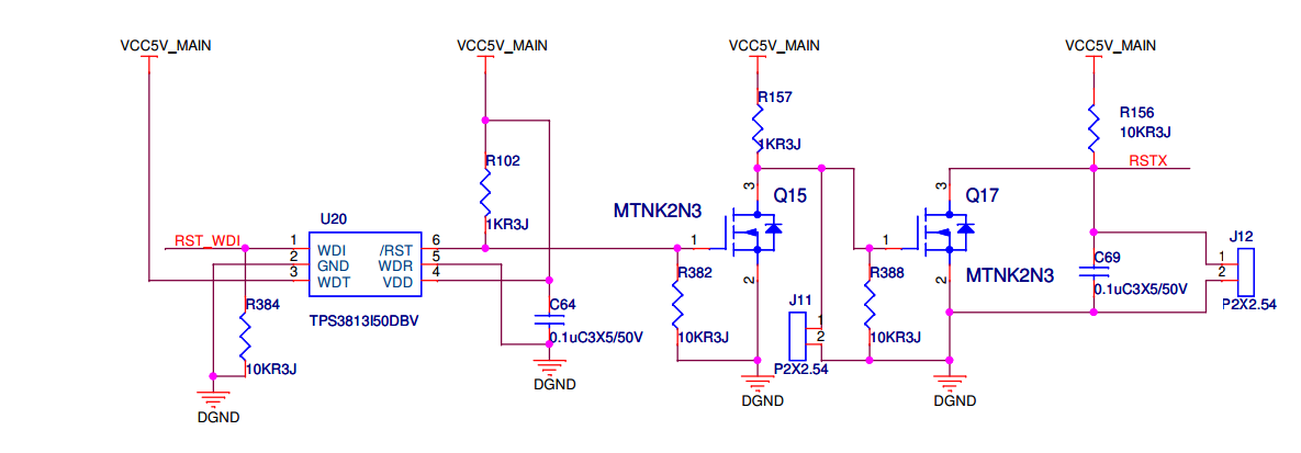

    and  as below circuit, we change R102 to 100Kohm, R382 to 1Mohm, add 470uF capacitor in Vcc5V_Main.
    sometimes affter Vcc5V_Main on but RSL pin will keep low....May you pls have some suggestion to us?

    The Vdd capacitor is meant only to ensure best stability of the threshold voltage.  We recommend a 0.1uF capacitor.  Is there a reason you are using such a big capacitor?
    Also can you share the purpose of R382?

    2. Why add resistor R382?
    For Vgs signal clear. It function like tps3813I50 R2 (no floating) .

  • Hi Bogey,
    It looks in your last waveform that WDI is not pulsing.  This will cause the device to time out.  Is this correct?

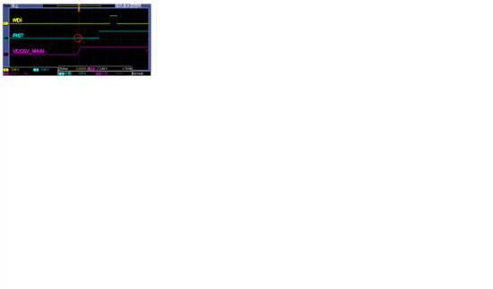

    Enclosed files are TPS3813K33 circuit and measured waveform(Ch2 is VCC; Ch1 is RST Pin)
    Sometimes RST will have clock output when power on.is our design have some problem?

  • Hi Bogey,
    To answer the much earlier question about the pull-up resistor value:
    The pull-up resistor cannot be too small as the RST/ pin can sink only a certain amount of current (around 4mA in your case for a logic low of 0.4V). A 1kOhm pull-up means your minimum output logic level would be 460mV if you didn't have the 10k resistor, as you are not able to pull enough current through the RST/ pin to drive RST/ low. The following application note explains a bit more on this:
    http://www.ti.com/lit/an/slva485/slva485.pdf
    Onto your problem:
    Your signal on RESET/ is at 1kHz. This does not fall within any of the timing specifications for the TPS3813 with your current configuration, so I expect the signal is coming from somewhere else. Do you have anything operating at 1kHz?
    One other thing - can you remove R382 and make R102 a 10kOhm resistor? This will make the driving requirements for the RESET/ circuit a bit easier, and could help solve the problem.

  • Hi Bogey,
    Not sure if I understand you fully - did changing R102 and removing R382 fix the problem?
    If that is the case, the reason for the limitation on the pull-up resistor is the drive strength of the output device for RESET. As per the EC table, with VDD at 6V the device can pull down reset with at most 4mA of current to 0.4V. This equates to a minimum resistor to Vdd of 1.5kohm, but to be on the safe side you should try and avoid this limit by an order of magnitude, hence the 10kOhm.

  • Bogey,
    I think that the part is detecting that too much current is going through the output device to try and bring down the output, so the part shuts down the output to protect the output device and tries again.
