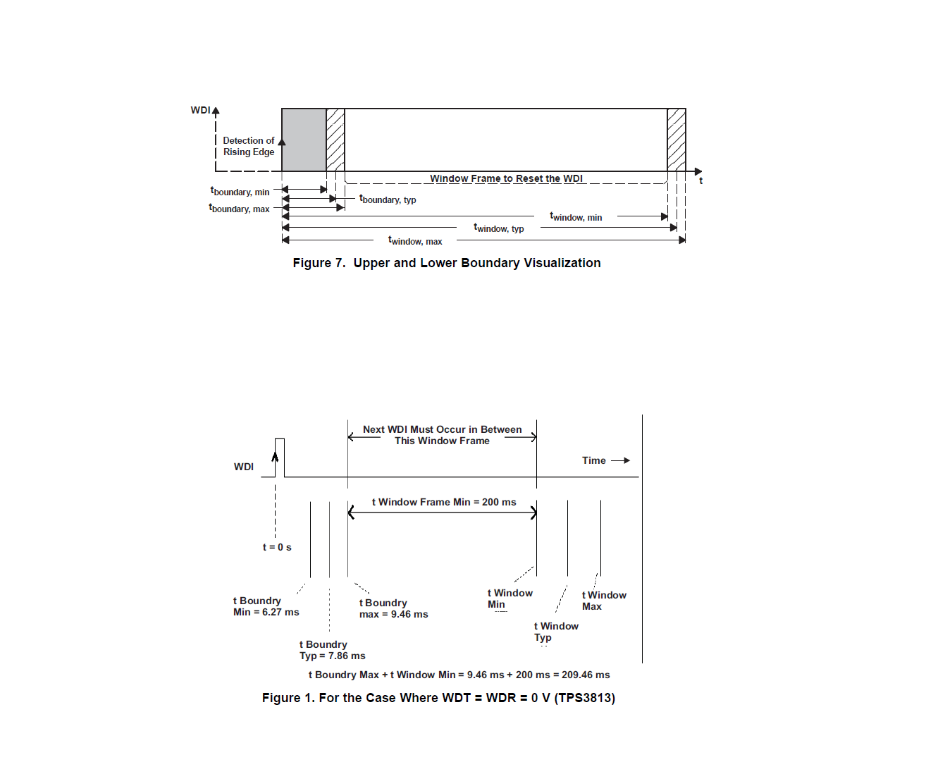

I am having simple question regarding tWINDOW definition.
FIGURE7 on the datasheet deines tWINDOW from rising edge of WDI.
However, FIGURE1 on Application Report(SLVA365 defines from tBoundary max.
Which is correct?

Dear, Ryan-san.
I guess the definition on datasheet might be correct because the device can't detect
tBoundary_max by itself.
However, both of documents are officially issued and can be download from web site.
I need your clear decision about that.
Hi Hideyuki-san,
Yes, please use the datasheet definition. We appreciate you bringing the discrepancy to our attention. Until we are able to fix the app note, please use the datasheet definition.

Dear, Ryan-san.
Thank you for your reply.
I will inform the customer to refer the datasheet, not app not.
