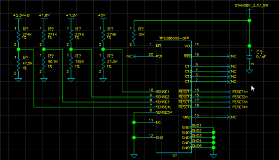

Im using a TPS38600 in one of my designs. In need 4 sense inputs however. The problem is the output of SENSE1 -->RESET1 is a function of the watchdog timer. I m not using the watch dog so these pins (WDI, WDO) will not be connected. I however dont want RESET1 to be influenced by the Watchdog. Is it possible to get RESET1 to behave like RESET2?
Is this possible?
