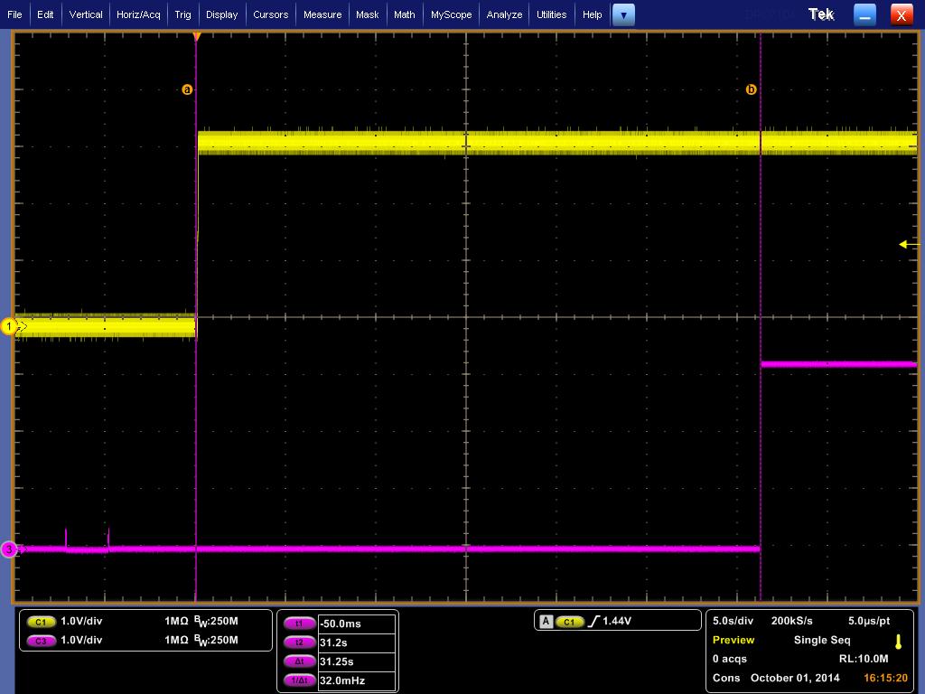

Actually, I would like to know what is the maximum delay this IC can offer?
i.e. Can i get the delay upto 5 Sec to 10 Sec by having corresponding capacitor?
Vasanthan N
Hi Vasanthan,
The maximum delay time is constrained by the leakage current through the Ct capacitor. As the capacitance value gets larger, the leakage current generally increases. At a certain point the leakage current through the device is not able charge Ct to the needed voltage.
This device is easily capable of doing a 5-10 second delay time, and the scope shot below shows a test I ran a while back with a 6.8uF capacitor to give a 30 second delay time. The device was a TPS3897A, Channel 1 (yellow) is SENSE and channel 2 is RESET (pink).
