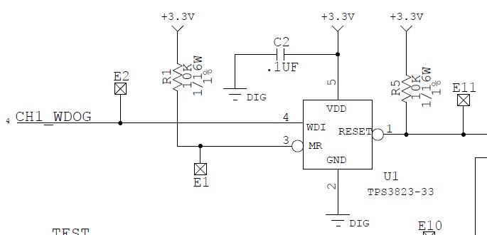

i am using TPS3823-33 non-A version on my board. i noticed from datasheet and other questions on this forum that i am not allowed to toggle WDI when RESET_N is asserted. otherwise, RESET output will remain asserted. i have some questions on what will happen if i stop WDI toggling.
this is what i see on my bench. upon power on WDI starts toggling and RESET_N pin stays LOW. when i manually disable WDI toggling RESET_N pin goes HIGH after Td duration. so far this is what i am expected. however, RESET_N stays at HIGH regardless my subsequent attempt to manually enable and disable WDI toggling. it is as if the watchdog IC does not function at all. is this expected behavior? please advise.
delay and timeout duration in the datasheet is only spec at room temperature. can you also provide the numbers over temperature range?
