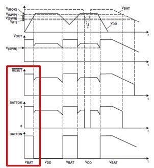

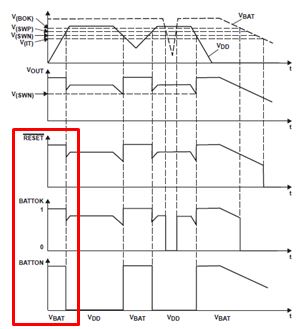

  • Thank you for your reply.
    I saw Timing Diagrum from datasheet. I think BATOK is enabled until /RESET is high. Could you explain more detail?

  • Hi Tateo,
    Vbatok starts HI - what I meant is that the measurement cycle does not start until RESET/ is HI (after either VDD/VBAT have passed their thresholds). RESET/ also starts HI, leading to that timing diagram - RESET/ will only go low once you have passed either threshold and then fall below the threshold.  Sorry for the confusion.
