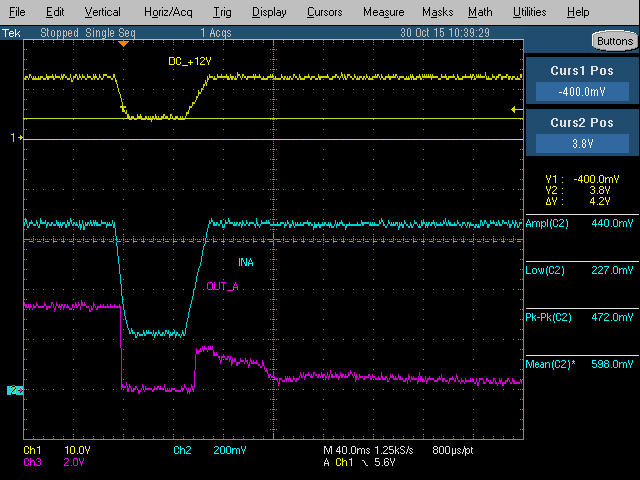

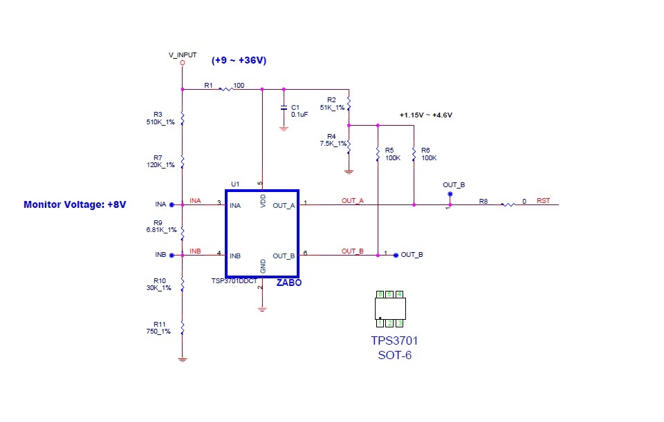

My customer used TPS3701 have some issue.
When monitor voltage fast on/off but OUTA can't Low to High.
you can check to below waveform.
Why OUTA can't low to high when INA low to high?

Does the OUT_A go high if you wait?

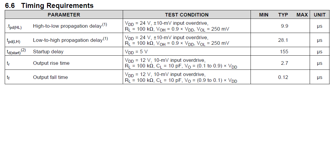

No, it doesn't. It will stay low if the on/off time is 30mS and according to datasheet, the (LH)delay time will be 28.1uS, you can refer below. but when test in longer on/off time which is 1S, the behavior will be normal.
Also are you seeing this on multiple parts or just one?
Multiple parts.
We will try to replicate your waveform.
Are the only conditions that you tried the 1s and 30ms durations?

Hi Ryan,
Customer ON/OFF condition is 1mS~1S duration.
Is TPS3701 can support it?
