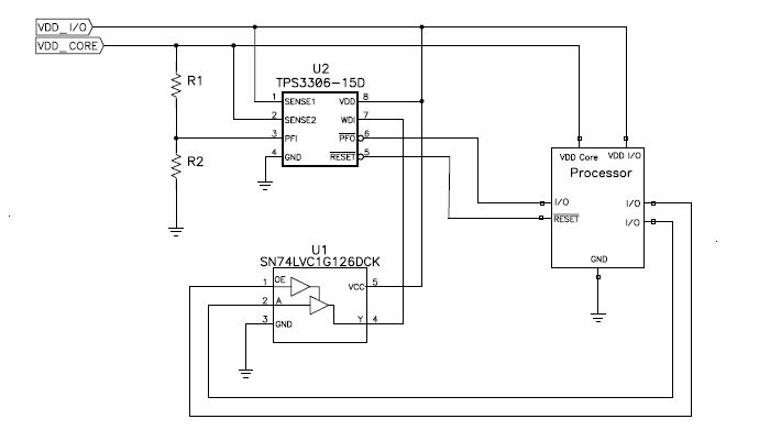

Looking for a Reset IC adjustable and with disable feature
Other Parts Discussed in Thread: TPS3306, TPS3850
Everything is in the title,
I tippically want to use this kind of application ( TPS3306 )  :
Let WDI floating is enabling the watchdog, which is pretty insteresting for me (page 2 : "Leaving WDI unconnected disables the watchdog")
But this seems to be a rare feature (contrary to what the manual says) .
Its design is simple and easy but I'd like to know if this kind of component exists with adjustable timeout (max and min)?
Thank you in advance,
Cheers.
  • Hi Olivier,
    It looks like you are using our Application Report on disabling the Watchdog Timer for TI's Family of Supervisors for your inspiration (www.ti.com/.../slva145.pdf). To clarify, for the devices listed in Table 1 of the Application Report, floating WDI will disable the watchdog functionality.
    For your application, are you looking to adjust the watchdog time or the /RESET delay time?

  • Hello Ryan,
    Yes indeed
    Regarding to my development, I am trully at the beginning: I don't even have a prototype yet.
    That's why I prefer to have an adjustable WD time and /RST time...
    Cheers.
  • Hi Olivier,
    We are currently working on a device that seems like a good fit for your application. The device, TPS3850, should release this fall.
    Very Respectfully,
    Ryan
  • Hey Ryan,
    Thank you for this information,
    unfortunately I can't wait for this device, so I'll keep the TPS3306-xx.
