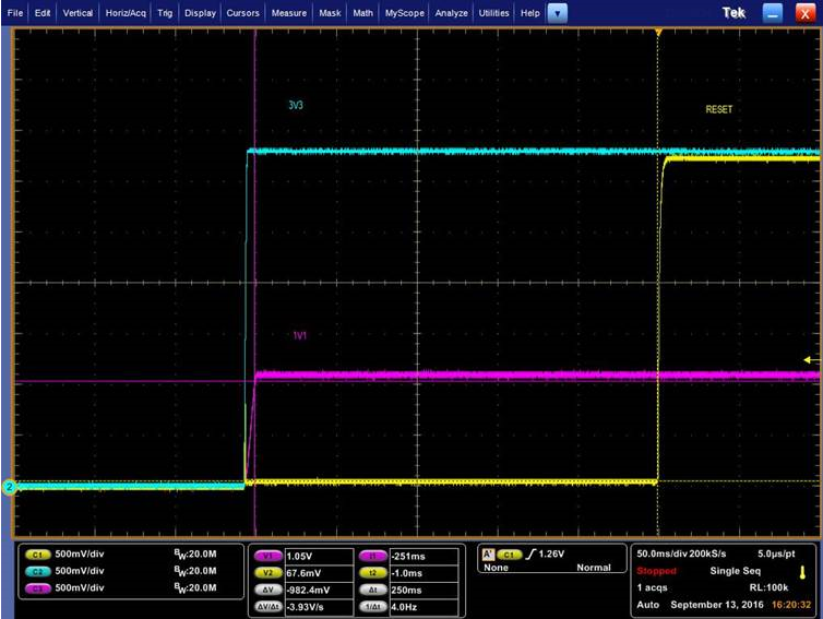

For the TPS3828-33DBVT reset output (Yellow line), we find it had pulse before 3.3Vout stable.
The figure shown below,

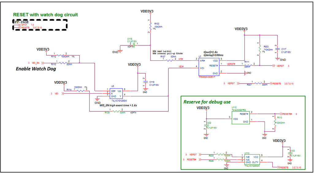

And the schematic is shown as below, please help to verify why it will occurs.
Thank you
