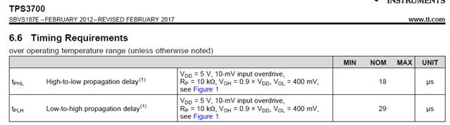

Customer measured the TPS3700 Tphl is 32us. On the TPS3700 datasheet, it only has nom value 18us.
Is 32us the expected timing?

We only provide nominal, typical values for the rising and falling propagation delay. This value can vary from device to device and also across all operating conditions. Other factors that are non-device related that contribute to changes in prop delay include layout, parasitic capacitance on the output pins, slew rate of input signal, overdrive strength of input signal, etc. This is why we provide just a typical estimation of the prop delay.
