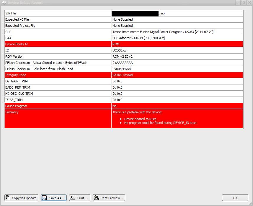

It seems like the sequencers arrived without factory pflash programmed. They do not respond on any address and it is not possible to program them. I figured out that they are responsive on address 11d in ROM mode. I managed to run UCD9XXX Device GUI and started debug tool and it shows bad checksum for Pflash. I also dumped Pflash from device using UCD3000 flash export, and both Program Flash and Data Flash are filled with 0xAA values. The problem occurred in all our devices so the problem does not concern one device but all of them. While looking for the firmware I found this file Which linked to Pflash file(page 45) but the link seems dead.

I used USB-TO-GPIO: USB Interface Adapter EVM as programmer

    Here is screen with debug report
  • For some reason, the program flash checksum is clear => that is why the device stays in ROM mode upon power cycle. To revive the device, you don't have to re-program the program flash, use the "UCD3XXX & UCD9XXX Device GUI" tool: power cycle the device, click on "Scan Device in ROM Mode", if device is found in ROM mode, goes to the "Checksums" tab and click on the Calculate link to calculate the device program flash checksum. If the device ID is UCD90120A|2.3.4.0000|110603, the checksum value should be 0x0036921D. If the calculated checksum matches the device's program flash checksum => click on "Recreate" link to write the program flash checksum. If all is well, after power cycle the device, device should come up in Program Mode.
