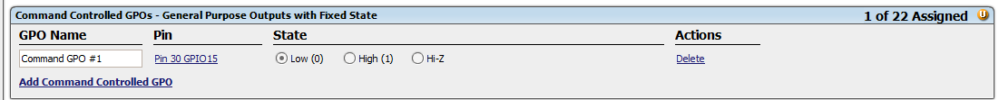

I’ve run into a problem with how I’m using the ucd90160.  I’m using a gpio as an output, and want to use the command control option for it.  The problem I’ve got is that I need to go to the reset condition of the gpio when the alert line is driven.  Is there a way to tie-in this condition?   Can it be done if configured as logic controlled output?
-Michael

    Could you help to explain what do you mean by " go to the reset condition of the GPIO  " ?

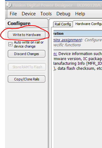

    If you changed the state of command control GPO, remember to Click "write to hardware" to confirm your change.
    You also mentioned "the alert line is driven", do you mean the alert line is asserted? can you give a screenshot of GUI to show that what kind of fault occurs?
