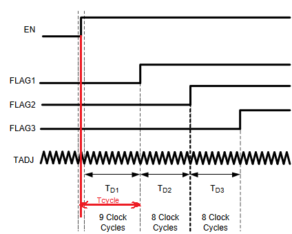

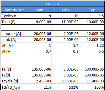

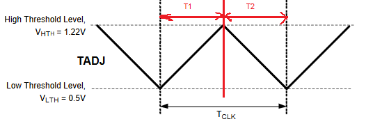

Corner case analysis of time delay give me incredible bad results. Please state what is max and min timing frequency of LM3881 for 5V power, and temp. 0-85deg.C, Tcap =10nF +-0%.
