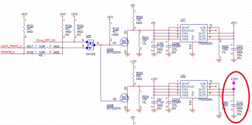

  • HI Rakesh

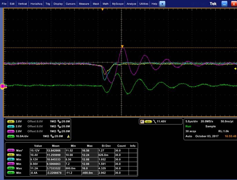

    When I use "Ultrastar SN200" this SSD on CN1 will meet inrush issue (schematic as below)

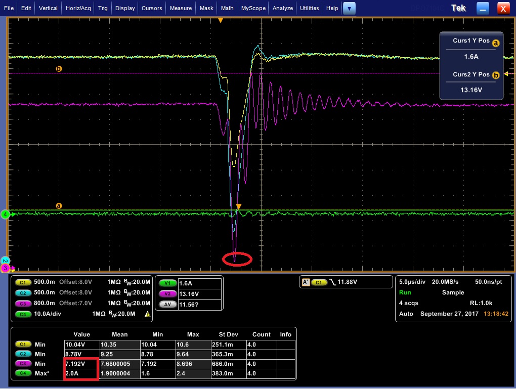

    When C121 pop ,the inrush current will be 13.08A and +12V1 will be drop to 9.484V
    When C121 non-pop ,the inrush current will be 2.4A and +12V1 will be drop to 7.192V
    May I know
    1. Do you have any idea why this inrush current is so big?
    2. Due to we don't want to cause TPS25296 to current protection ,what's value of C121 is suitable?

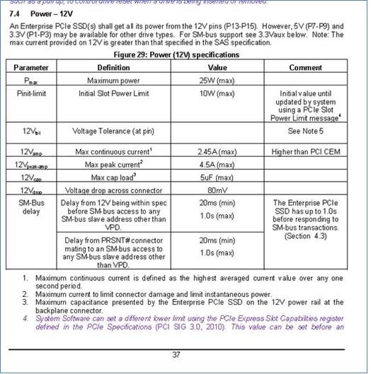

  • HI Rakesh
    Below is SN200 SPEC
    If you have any suggestion ,please kindly let me know
  • Hi Kai Hsiao,
    Thanks for more details.
    In the test waveforms - what does yellow and blue color trace corresponds to ? Is it the input voltage +12V of U52?
    Are you hot-plugging "Ultrastar SN200" SSD on CN1 connector after +12V1 becomes stable?

  • HI Rakesh
    CH Yellow: Close to PSU +12V Net Voltage (power supply for Backplane)
    CH Green: NC U52 measuring + 12V to + 12_1 current
    CH Blue: C67 that +12V Net Voltage (Before the eFuse)
    CH Pink: C121 that +12V1 Net Voltage (behind the eFuse)
    When We follow SN200 SPEC and change C121 from 22uF to 4.7uF
    Inrush current still have 11.2A
    Inrush current happened on re-plug condition
  • Hi Kai Hsiao,
    When "Ultrastar SN200" SSD is inserted on live +12V1 bus, eFuse limits the current to max 5.2A (corresponding to Rilim 150kohm). It looks strange to see both input voltage +12V, PSU +12V Net Voltage (power supply for Backplane) dropping. Is this repeating on all of your boards?
    how does the system (along with SN200) behaving when you toggle "Drive_OFF_NO" signal? Have you tested SN200 module by separately powering it from 12V DC source - how is the inrush current profile ?
