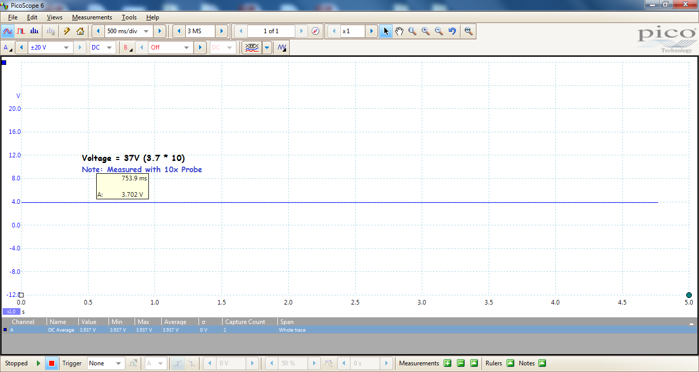

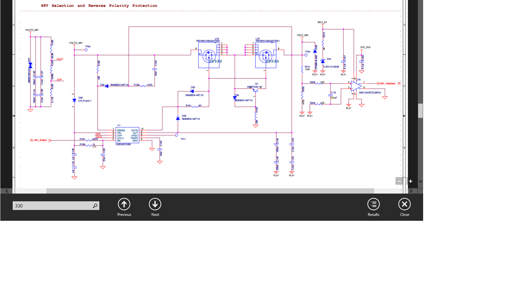

We have used LM5060 for 48V side bus as a output protection device.Its an Automotive application. We are using two MOSFETs (IPB180N10S402ATMA1 )are connected in series .
We are not able to drive these MOSFETs ,We have forced deactivation for UVLO and OVP.  I have attached the waveforms also , Please help us to resolve these issues. I have also attached schematic
  • Hi Raghavendra,
    Welcome to E2E! Can you reupload the waveforms and schematic drawings?
    I suggest taking a look at our Design Calculator for the LM5060. The calculator will help determine if the schematics/MOSFETs are ok or not. The calculator will also explain why UVLO are OVP deactivated.  After the calculator is filled out, we will be able to assist you further with the additional information.

  •  Hi Arthur,
    Thanks for your reply, we have used Design calculator for LM5060 ,  We did below changes in the schematic (attached below )
    Ctimer = 3  363nF (220nF|| 100nF|| 33nF )
    R181=  2K ( Gate series resistor )
    removed C145 ,C24  (connected between OUT pin PGND )
    It worked for some time and we tried testing it with capacitors between OUT and PGND , after that it stopped working.
    We are using IPB180N10S402ATMA1  MOSFET with 200nC Qg and 2.5mohms
    Sometimes we see voltage on nPGD is more than 0.4V , does it mean is it due to VDS fault delay ?
    Also in TIDA-001168 schematic,  47nF is being used  for Ctimer , for 48V side protection ,please suggest
    can we force deactivation of UVLO and OVP  and test or it is mandatory  to have.

  • Hi Raghavendra,
    I took a look a the provided schematic, and it seems that your UVLO and OVLO thresholds are set incorrectly for 48V operation. The OVP is currently set at around 25V while your UVLO is around 7.22V, which is low for a 48V application. This can cause an inrush event as the FET voltage rises from 7.22V to 48V and DV/DT changes.
    I would recommend testing the current setup at 20V and seeing if it works with the current UVLO and OVLO. If it works correctly, then we know that the circuit is set up properly. After that, calculate different UVLO and OVLO resistor values and make sure they work with the input voltage range.

  • Hi Arthur,
    We tried with 12V, we also forced UVLO to high and OVP to low (disabled UVLO and OVP ). It dint work.
    MOSFET enhances up to 2V sometimes but not fully .Ctimer values are changed as per the recomendations from the datasheet (47nf--68nF ). Just to test we have also tried with MOSFETs with low Vgs(th), it didnt help.

  • Hi Raghavendra,
    Apologies on the delay. So the device does not work at 12V even with UVLO and OVP disabled?
    If the MOSFET is not fully turning on, it might be an issue with the gate enhancement. What type of load are you driving downstream, and what is your output capacitance? I put your information into the calculator myself and everything seemed to be nominal, so you are within SOA and normal operating conditions.
    Can we get some oscilloscope shots, similar to the ones found on page 25 of the datasheet? This will give us a better indication on why the FET isn't turning on.

  • Hi Arthur,
    Thanks for your reply, our 48V Circuit breaker is working now , We followed LM5060 calculator , Changed Ctimer =100nF, Cgate=4.7nF , added 10uF to the output . Thanks for your support .
