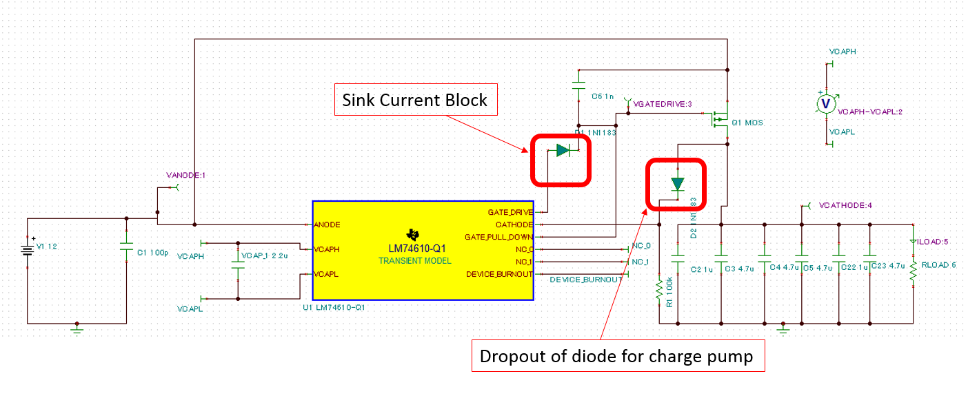

For avoiding Voltage drop during T0, we would like to change schematics as the attached file.
Are there any concern in the attached file?
I add the Diode between FET gate and GATE DRIVE pin for disable the gate sink from GATE DRIVE pin.
And add the Diode from CARTHODE pin to Drain of FET to getting Vf voltage drop for charge pump.
Also, we add the diode and resistor to protect reverse battery.
In my customer ,there is the boost converter after LM74610-Q1 and this voltage drop induce unstable operation of the boost converter.
I appreciate it your support this issue.
