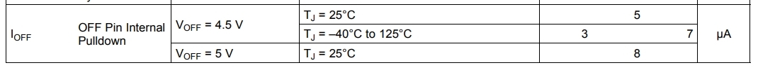

We are going to calculate the pull up resistor at OFF pin. The pull down current is defined as below,
How much is the pull up resistor calculated at pull up supply voltage = 25V~50V?
The pull down resistor will be calculated as below.
   4.5V/3uA=1.5Mohm
   4.5V/7uA=643kohm
Is my understanding correct?
