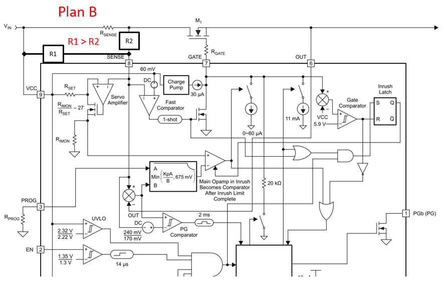

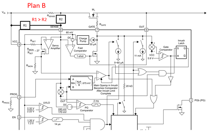

Is it possible to connect a resistor in parallel with Rsense to fine-tune the current limit threshold ?
Could you please give me your advice as the folllowing plans(the plan A and B) ?
In addition, is my understanding correct that there are concerns regarding the transient response and the voltage error based on the input bias current of SENSE pin ?
