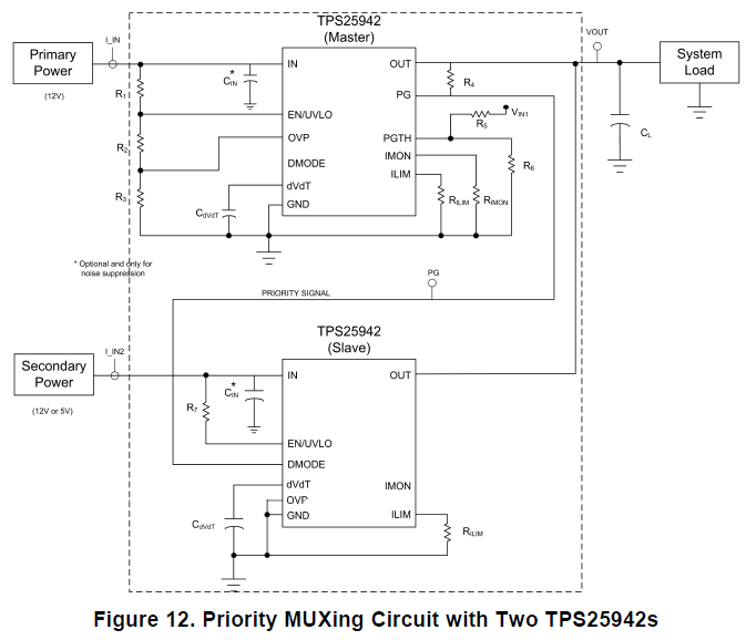

But according to application report (SLVA811A : Figure 12.page 14), if using two TPS25942 for power MUXing,
then when the primary supply is disconnected, reverse current will be able to flow through the master device.
In this case, how should I understand? Could you please tell me more detail?
If reverse current is less than -235mA, is it will able to flow through master device?
Tao2199
  • Hi Tao,
    Typical reverse current of 238mA (for short interval <3us) is needed to establish reverse voltage of 10mV for detection and turn-off the device. When the primary supply is disconnected, the output cap charges the input cap and helps to establish spiky reverse current for a short interval. But, in this process, if reverse current is less than -235mA, the device remains in ON position.
    We will take action to modify the sentences in the documents for clarity.

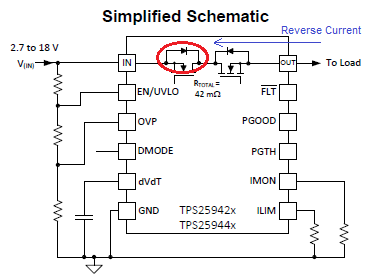

    When the primary supply is disconnected, will reverse current be able to block by parasite diode
    on internal FET?
    It seems that it will be able to block from Simplified Schematic. (datasheet,page1)
    What is different between behavior of parasite diode and fast reverse comparator?
    Tao2199
  • Hi Tao,
    The fast reverse comparator turns OFF the FET circled in your post and then the parasite diode block the reverse current flow.
    Rakesh
