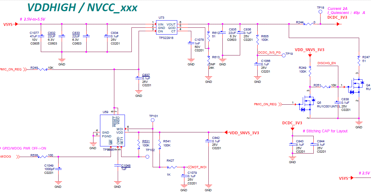

Dears:
Pls. kindly help to check the below schematic, and we let the TPS22918's on pin to connect GND signal for a moment, then disconnect GND signal for testing the performance.
And the pin of ON is always keeping low after the test.
And I find the Von can be -0.3V, why the pin of ON is always keeping low?
Pls. kindly help us!
Thanks a lot!
