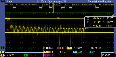

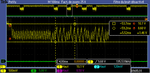

Our Charger is planned to charger @780mA 8.4V.
However, during BQ500215 / BQ51025 Dialog, il looks like the DC out fall down a little too much (down to 8.62V) so that our charger can't be at constant current charge and sometime Just don't charge
First ScopeScreen is the output of BQ51025 on a pure 10 Ohms resistor
Yellow : Output
Second ScopeScreen is the the output with charger running
Yellow  : Output
I've got 2 questions according to that :
- Is there a way to restrict Dialog timing
- Do you have a Clue/hint to limit the swing voltage during dialog in order not to drop down to 9V.

  • The pulses on the output are definitely the communication signals.  The signal depth is dependent on the coupling between the systems (RX and TX coils).  As you change the coupling (X, Y and Z distances) you may see the pulse depth change.  Changing the capacitance on the AC1 pin will have an impact as well.
    Added capacitance at the OUT pin of the bq51025 and at the input pin of the charger may improve your results.
    Alternatively, increasing the VOUT may keep the communication pulses from interfering with the charger.
    Dick
