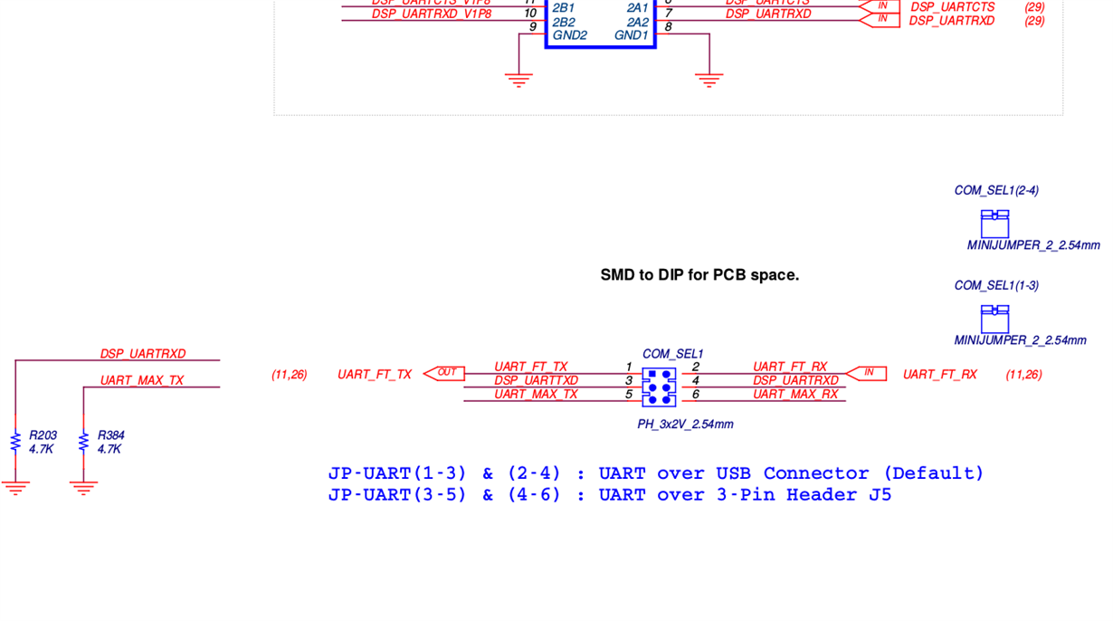

i'm trying to execute the example code of UART ןמ PDK 2.0.8.
i succeeded to send and receive the characters via the internal UART port (over the emulator USB port).
Unfortunately, i failing to find how i configure the transmission to be on the external UART port (the 3 pin on the EVM board with COM cable).
what should i do to achieve this? which configurations should be  modified? any platform functions to run?
