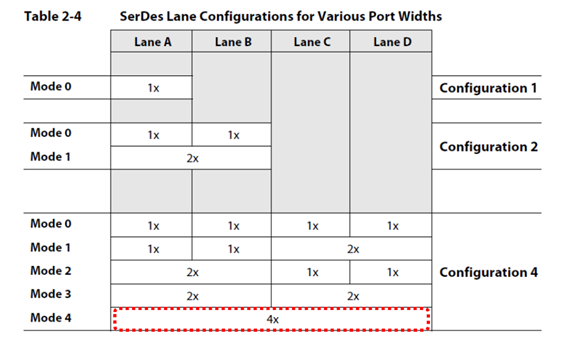

Dear Champs,
My customer failed to set SRIO for 2.5Gbps mode(half rate) at mode 4 of configuration 4(4 lanes used) to achieve 10Gbps.
But, there is no issue when they set it 1.25Gbps mode(quater rate). Their SRIO is connected to FPGA.
When they failed in 2.5Gbps mode, they failed at port, link initialization.
Could you please check below their settings and let me know what should be modified?
To change bitrate, they modified MPY value and RATE value only as in below. Are these enough to change bitrate of lane?
Is there any other thing should be modified when birate changed?

their target configuration is as below.
