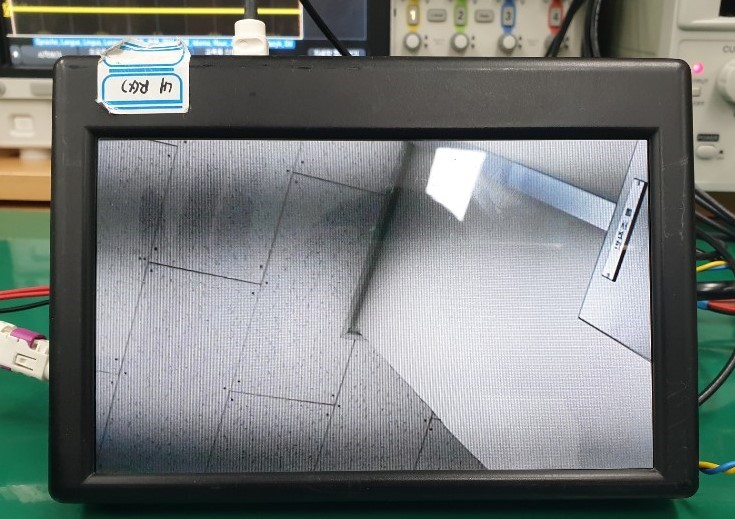

I have made two types of the H/W with a slightly different name of TDA Soc
At first, everything looks fine including display like a picture #1 when I use TDA2HVBRQABC(R)Q1 on the H/W

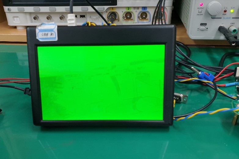

However, I have been facing an uncertain problem that display image comes out with little green chroma like a below attached picture#2 if I use TDA(TDA2SXBTQABC(R)Q1) Soc

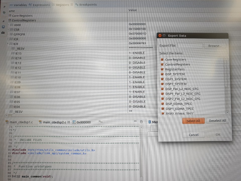

The vision SDK software is used with original released version from TI and used same S/W on both side..
we have measured there is 2bits missing on the image data like an attached picture #3
picture #4 is the information of measuring point
My question is that the two types of the TDA soc is 100% compatible with same vision SDK software including BSP specifically video input part? So there is no chance the possibility coming different output because of the S/W?
