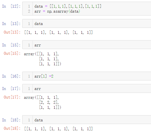

  • when use np.asarray(arg_info) to convert arg_info object to a ndarray object and modify the ndarray object , the arg_info object is not modified.
    I send different picture data but I always get same result from outputbuffer. so I suspect the input data do not work??
        We use python buffer protocol for accessing EO/EOP's input/output buffers.  Using np.asarray() is one way of accessing them.  Enclosed is a complete imagenet example that uses OpenCV to read/transform image file, place data into EOP's input data, run network, and process output data.  Hope this helps.
    - Yuan
