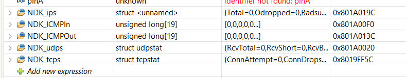

    4) For NDK, there are some global variables, you can add into CCS expression window (see below) to check how many packets Tx/Rx.
    5) For NIMU, we typically add some global counter for Tx and Rx inside nimu_eth.c to track.

    It looks like there is a issue with rtable.c, by disabling timer " _RtNoTimer = 1" the extra arp requests are gone and the problem of comm drop seems to be gone too.
    What I believe is happening, regardless of whether data is flowing on a given IP address it will clear the table entry when the time has expired, thereby creating the arp request. However, if a send command is requested before the table is repopulated an issue is created. What I believe should happen is if data is flowing, the timer should be reset so that IP entry is not deleted from the table.
    In addition, If data is not flowing and the timer expires an arp request should be sent and if and only if there is no response from the arp request then the entry should be deleted.
    I hope this make sense??
