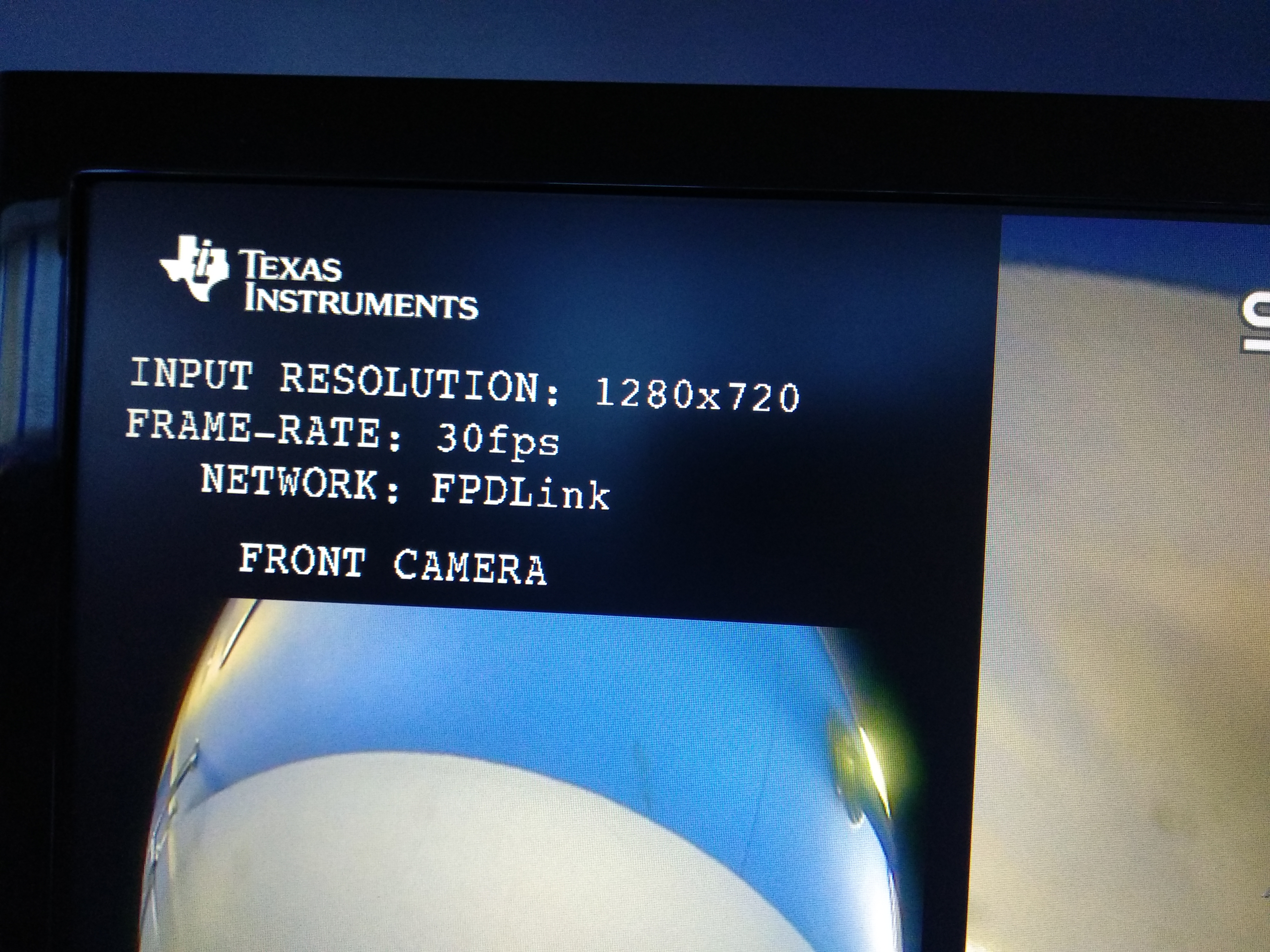

Hi.
I would like to display some custom text and symbols in 3D SRV use case.
Which files should i edit to achieve the same.
Thanks & Regards
Anusha

Please go through below modules
\vision_sdk\apps\src\rtos\modules\grpxSrc
vision_sdk\apps\src\rtos\draw2d
And look for Draw2D_drawString()
Anuj
GrpxSrc link work on RTOS.
So it doesnot matter whether you use linux or RTOS on VSDK.
It will work.
Anuj
I think you are using surround view layout.
So please make change there.
1st understand which piece of code is going to execute before making any change.
Put any logs to confirm that your changes is executing.
Anuj
