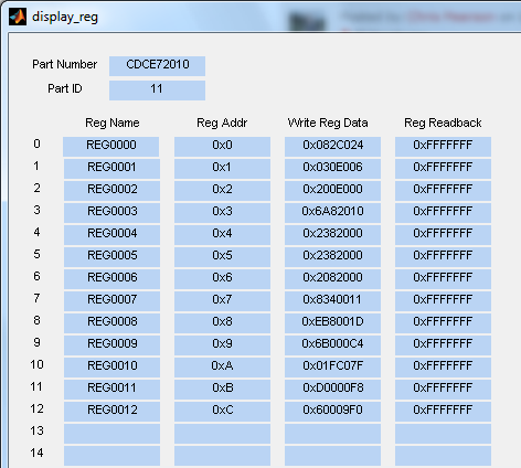

  • Hello Chris,
    I have checked the registers' values and they seem to be OK, although the write and readback data is not exactly the same in some cases:
    However, in SCBP mode using the tswconfig, this values are not written:

    Hello Guillermo,
    Thanks for all the information.  First I would like to describe some of the differences and functionality, and then after that maybe we can think best how to proceeed.
    In stand alone mode, register 11 and register 12 read different values for write and read data.  The difference seen in register 11 (D0000F8 vs 90000F8) is expected and is of no concern.  D=1100, and 9=1000, the 2nd bit is a read only bit used to confirm if the CDCE72010 EEPROM is locked.  We do not use the CDCE72010 EEPROM with the TSW3725 and there for the EEPROM is unlock and should read a 0.
    The difference seen in register 12 (60009F0 vs 60009B0) is the problem we are chasing.  F=1111, and B=1011, the 2nd bit is used to read if the CDCE72010 PLL is locked or not.  This bit has the same functionality as LED D3.  When D3 is on this bit should be a 1 and when D3 is off it should read 0.
    In SCBP mode, it looks like you are not able to readback.  When SW2 is in SCBP mode readback through the USB is disabled.  Using switch 2, It maybe possible to program the TSW3725 in SCBP mode and then switch back to stand alone mode for readback.  This would probably be a good thing to try.
