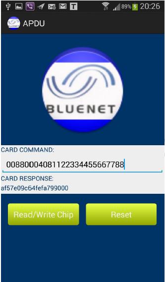

    I have received some information from the developer who issued these cards. He mentions the following:
    you don't need to select the Applet. The application installed on the Smart Card in your hand is default selected.
    You will find attached the source code of Android APDU applet.
    As I understand he mentions there is no special SELECT command to be issued and the applet is default selected. In the android app he has developed he is issuing the following command:
    00 88 00 04 08 11 22 33 44 11 22 33 44 (in hex)
    and the card replies the following
    af 57 e0 9c 64 fe fa 79 90 00 (in hex)8611.SourceCode_App_APDU.TXT
    I am also attaching the android source for reference if it helps. I need to send the APDU as above and get the response using the TRF7970AEVM. So far I have suceeded to get a reply to the RATS command. Any idea what is happening here and any suggested future steps
    Your help is highly appreciated.
    Thanks in advance
    Royston
    5340.SourceCode_App_APDU.TXT

  • Dear Josh,
    Thank you for your response, but since I am expecting a response of data from the card, as shown in the app image above...Should the APDU command also consist of the Le field....(expected bytes)
    Sorry for my naive questions, but I am beginner on smart cards.
    Royston
  • could be but you now know the form to use to get communication out and you can get a copy of ISO7816-4, too.
