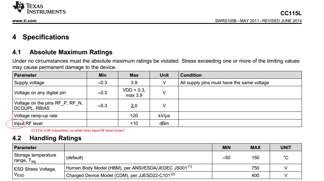

CC115L is RF transmiter, so what does Input RF level mean?
Other Parts Discussed in Thread: CC115L
Please explain the term. Input RF level in below capture.
  • Even through CC115L is a transmitter the pins could be viewed as inputs. Example: The CC115L is turned off and placed close to a different transmitter with high output power causing the power on the RF_P/ RF_N to be high. This has to be taken into account even though the circuit is transmit only.
