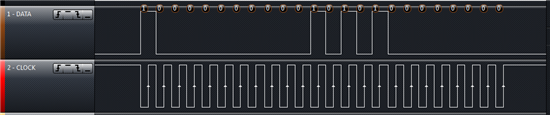

What values must be sent to read a register? When I probe the Data pin while pressing the read button for a register (using CodeLoader) I see the following:
After a read command (for register 0x15), it seems to send one clock (1 data bit = 0) followed by a delay. After the delay, the is a transmission of 24 bits.
This is close up of the initial clock signal.
This is a close up of the 24 bit transmission following the delay. It is equal to 0x801500. Am I correct in assuming that the (read) protocol is to send a single low bit, then to wait for a certain period of time, then to send 24 bits with the leading bit being high and the following bits being used to specify the register that we would like to read from? Should the final byte always be 0x00? Should the value of the register be seen on the MUXout pin following this command?
