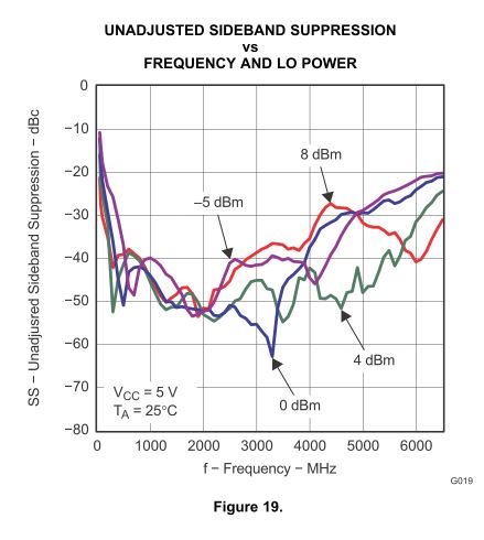

Could you please let me know the data of UNADJUSTED SIDEBAND SUPPRESSION vs. FREQUENCY and LO POWER at the differential LO input?
All typical characteristics is measured on single-ended LO input.

There is no degradation. D/S characterization was done with SE input. The biggest variation is related to the LO amplitude signal. Refer to the datasheet for the plots of Carrier Suppression vs. frequency over LO drive level.
