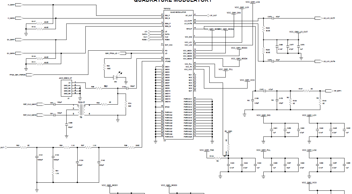

We are using TRF3722 for output frequencies 2300-2400MHz. The IF input at each of the pins if -12dBm approx. But the output is around -32dBm. What might be the reason? Have attached my shematic.

  • Hi Sarika,
    Although it was a little difficult read, after looking at your schematics, I don't see any obvious issues. However, I would like to ask you if you could provide a screenshot of your output, that also includes the LO output and the sidebands as well. This could help give me a better understand as to what the cause of the issues is.
    Also how exactly are you sourcing your inputs. Test Equipment? DAC?
    Oscar

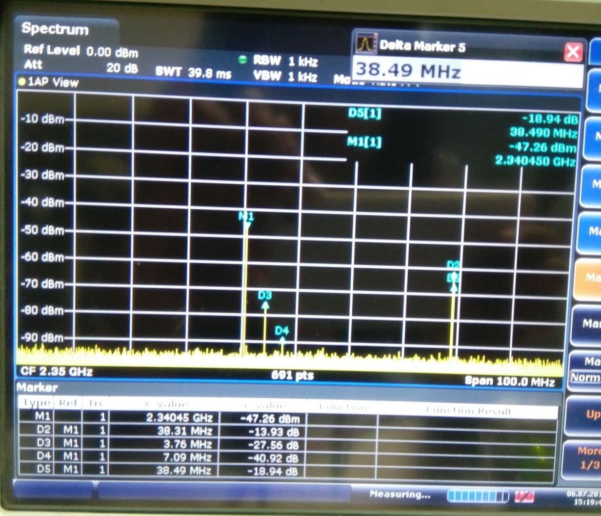

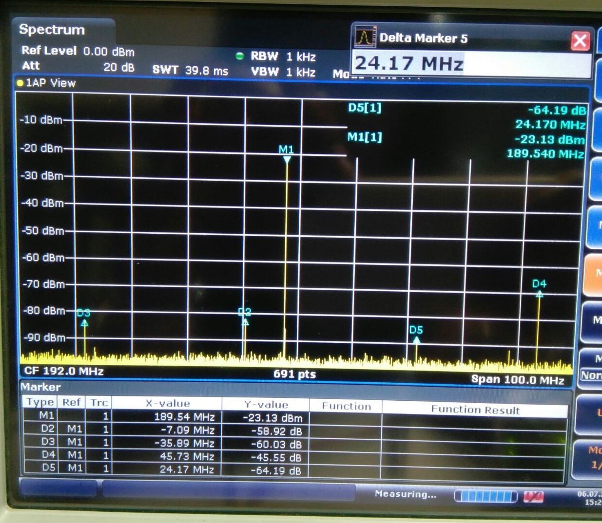

  • Hello Oscar,
    The inputs are provided using DDS. PFA for the screenshots.
  • Hi
    IF = 189.54MHz,
    Output RF = 2.34045GHz and
    LO = 2158MHz.

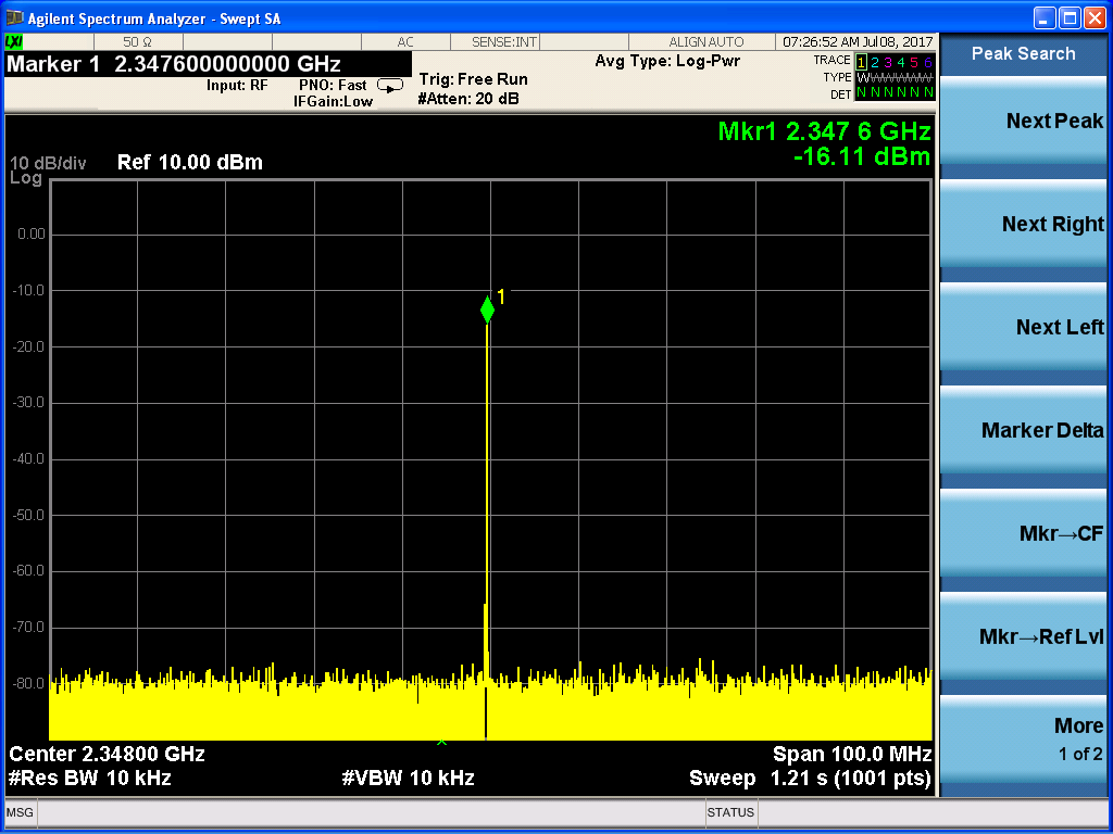

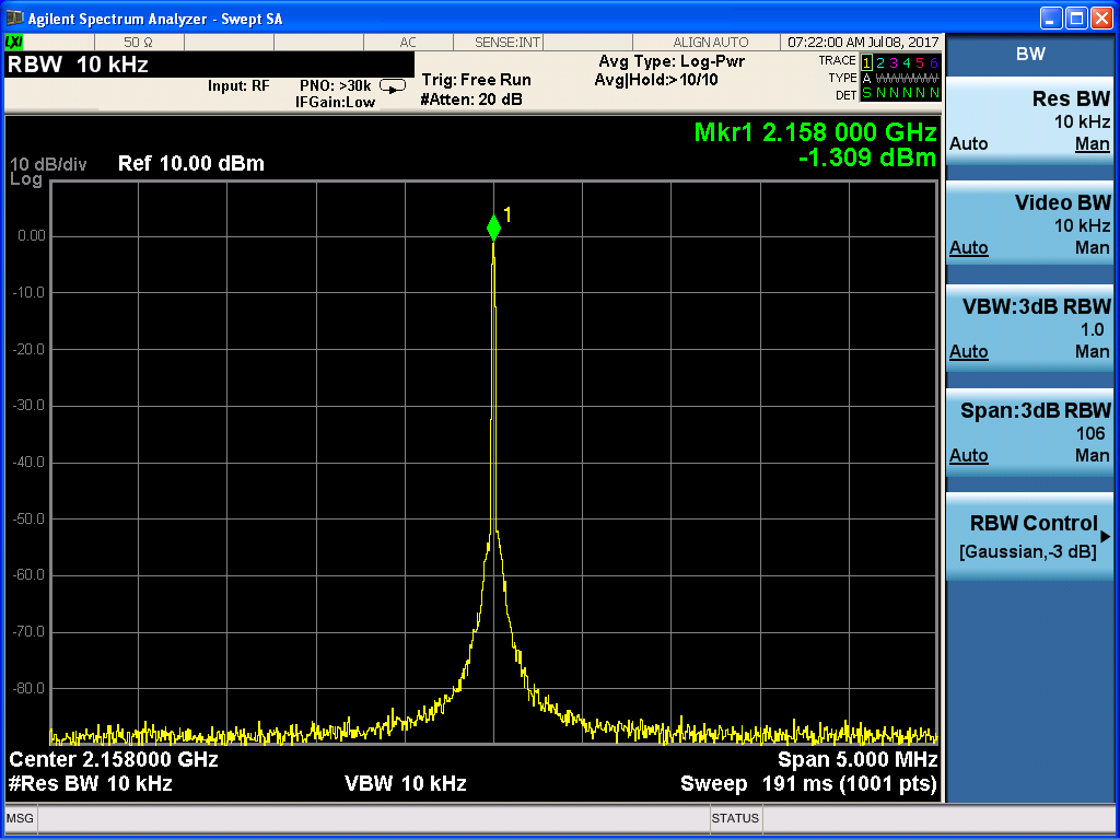

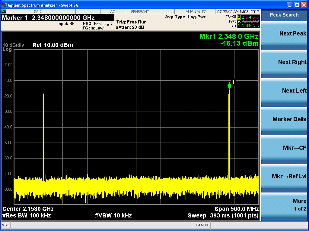

  • Hi Sarika,
    Using your configuration settings, I uploaded them on my own TRF3722 set-up and confirmed that there is nothing wrong with your register settings. I have attached images of the LO, the LO with both sidebands (I did not use quadrature inputs, therefore both sidebands will be present) and the RF output.
    I tried to capture the LO and the RF output with the same settings that you had in your captures. But a few things that I noticed were that your LO output is much noisier and even has some spurs. Also with the LO @ 2158MHz and the BB input @ 189.54MHz, the resulting RF output would be (189.54 + 2158) = 2347.54MHz. In your image I see a tone that would land at this frequency (D4 in your first image), however I am not entirely sure what the other tones in that image are.
    I would like to ask for another screenshot of your RF output, but this time have the center frequency be the LO frequency (2158 MHz) and the span large enough to capture both sidebands. I believe 500 MHz for the span should be sufficient as I have that same configuration in my image.
