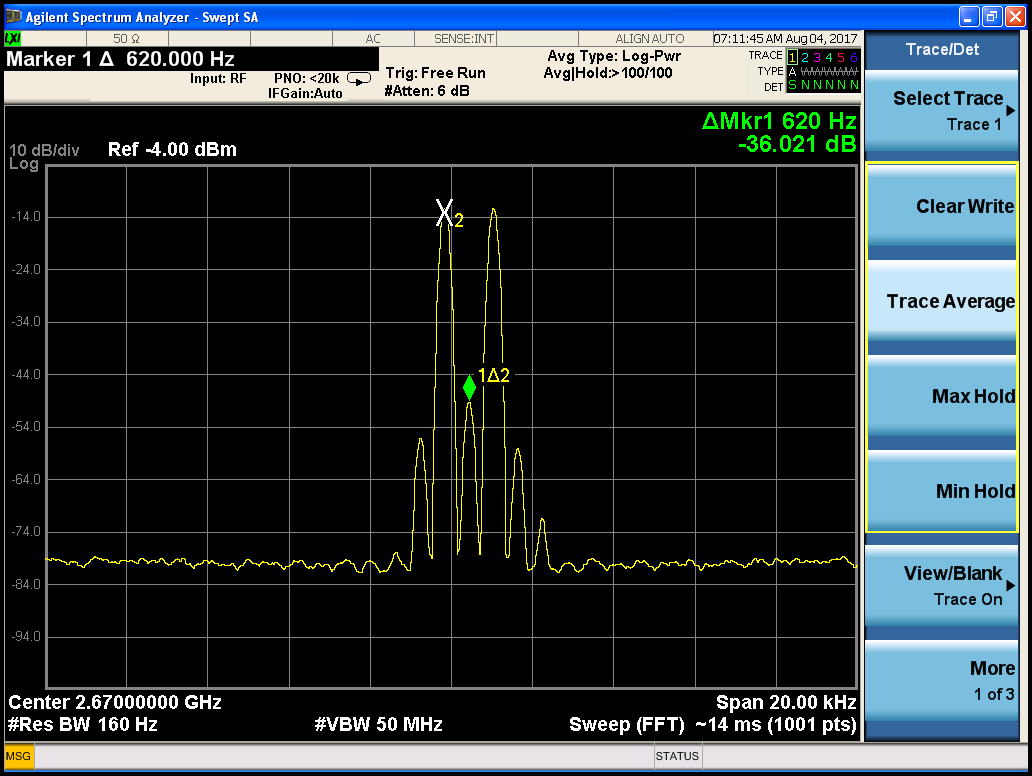

our customer working on  IQ modulator IC TRF3722, facing problems Regarding carrier suppression and amplitude imbalance.
pls find attached plots when operating TRF3722 IC with I,Q signals of 600Hz and LO freq of 2670MHz.
When operating with normal mixer the spectrum plots are good compared to TRF3722 IC.
Please help us in understanding degraded performance of TRF3722 IC compared to normal mixer.Normal_Mixer.zipTRF3722.zip

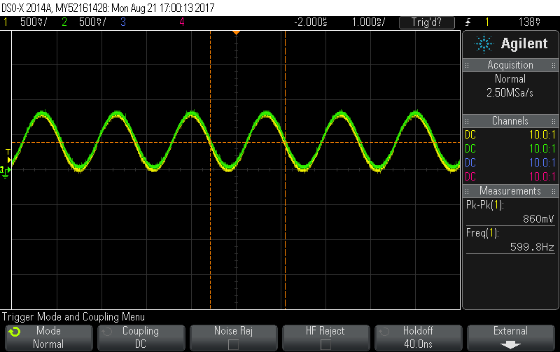

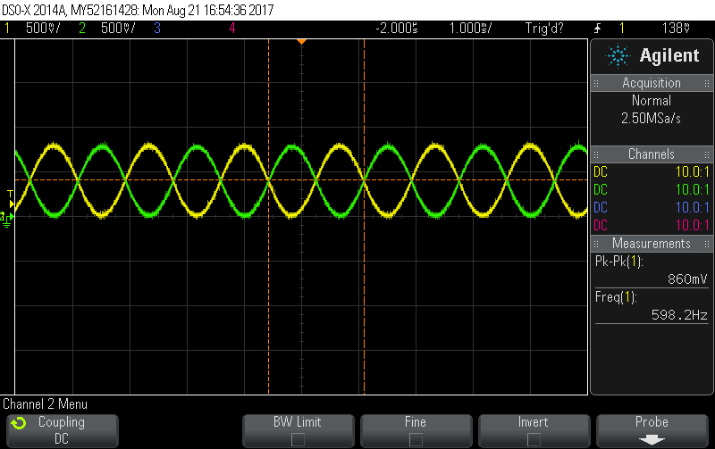

    I am attaching the I+,I- and I+,Q+ signal plots going to TRF3722.
    There is no amplitude or phase error as we can observe.
    Please comment.

    Your original screen plots look strange to me. In a typical modulator output you will see the wanted sideband (2.67GHz + 600 Hz in your case), the carrier feed-through component (2670 GHz in your case), and the suppressed lower sideband (2.67GHz - 600 Hz in your case). Your screenshot shows low amplitude and no sideband suppression.
    If the 1st O-scope plot is I+ and I- then no issue there. If the 2nd O-scope plot is I and Q then these signals should be in quadrature. If they are not in quadrature, then you will not get the sideband suppression.
    It looks like there is also some other PLL issues. Verify that the device is set-up in fractional mode with a relatively high PFD setting (20-35MHz). The signal swing looks OK but try backing off a few dB to see if there are any improvements. The high harmonic content and low fundamental amplitude look like the device is overdriven.
